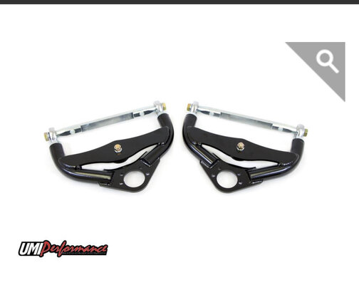

Hey Guys I have an at home alignment tool coming in next week and need ideas on how to adjust the upper arms. With the car on the ground at ride height I took one of the bolts out for the hiem joints and like I thought the arm shot forward. Any ideas on a better way than jacking up the car every time I need to make the adjustment?
Arms I have:

don;t take the bolts out just loosen the bolts enough to put in aligement shims they are open on one side slides right in there
