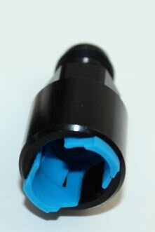

i bought a cheap eBay one 0-100 regulation range complete with gauges and AN fittings for a test for my LS project with 2 walbro 450 pumps , its been in 2 cars and its years later now and I'm still using it. i was going to replace it but it still works fine . $30.00 its a black one I think it has pny on it or something like that . some advice don't use any snap connectors for AN fittings i had one pull apart almost burned my car down.

I'm glad i hoarded my parts back when because buying anything now is terrible. and this is the fitting i used that almost burned my car down
