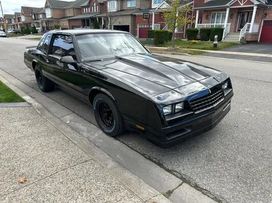

Hey everyone, I'm new here. I pick up a 1981 Monte Carlo about 3 weeks ago. It has a 2004 Silverado 5.3 in it and a th350 automatic transmission. The transmission will stutter when I'm slowing down, sometimes metal rubbing as well. I also wanted to make sure if the th350 came with 3 gears and over drive because I only notice it hitting 3 gears. Let me know what I should do.
I've also attached the car to show ya'll how it looks.
