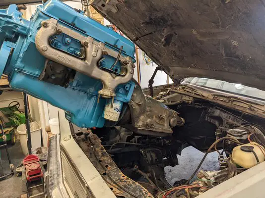

Are headers that big of an improvement over manifolds? Mine are supposedly a bit better than 'stock' ones. I like the idea of headers, but wouldn't want to spend a ton on them as they would be useless once I do an LS down the road.
Attached is what they look like.
